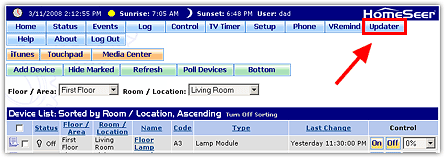

  DETAILS - From the web interface of your HomeSeer system, click the 'updater' button to access the online updater. You'll need to be connected to the internet.

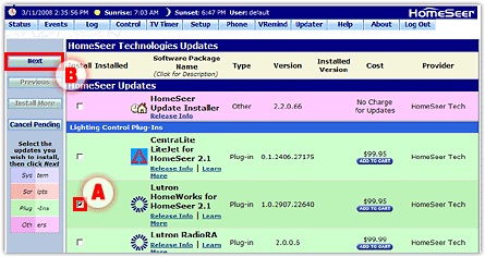

  DETAILS - In the updater, click the 'next' button until you get the list of plug-ins. Then, check the box next to the plug-in your wish to download (A) and then click the 'next' button again to begin the download and installation of the plug-in (B). Once the installation is complete, you'll need to restart your HomeSeer system.

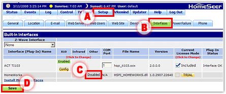

  DETAILS - After restarting HomeSeer, click the 'Setup' button (A) and then 'Interfaces' tab (B). On the Interfaces page, find the plug-in you installed and click the gray 'Disabled' button (C) to 'Enable' it and then click 'Save' (D).
  At this point, your plug-in has been installed and enabled and should be ready for use. Refer to the plug-in's documentation and release notes for configuration settings (if any)
