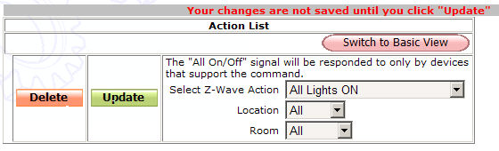

Devices that do not support the command selected will not respond to the action. For example, a device that does not support the "All" class will not respond to the All Lights On or All Lights Off commands.
Two of the command options available are All Lights On and All Lights Off - it is common for Z-Wave devices to support these commands. You can select a room and/or location for the "All" command to be issued to. All of the devices in the indicated location/location2 (Room/Location) will respond.

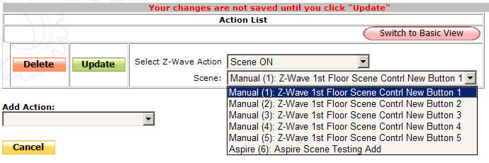

Z-Wave scene activation/deactivation commands can be sent with the "Scene ON"/"Scene OFF" actions. You can activate scenes that are found in controller buttons, saved Z-Wave scenes, or saved Z-Wave scenes imported from a Cooper Aspire handheld remote.
Only scenes found in saved scenes and controllers will appear in the list of scenes that can be activated or deactivated.

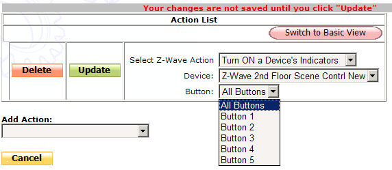

The Cooper scene controllers and accessory switches support the indicator class and allow HomeSeer to send them commands to control them. With this capability, you can activate a scene using a HomeSeer event, and then set the indicator on the controller to match the scene status. Note that when this action is used, the device is logically in the state you set the indicator to: If scene button 2 is on, and you use this action to turn it off, pressing the button will cause the scene to be activated - setting the indicator changes the logical state as well as the indicator.
Only Cooper devices which support the "Indicator" class will appear in the list of devices (indicators) that can be turned On or Off.
