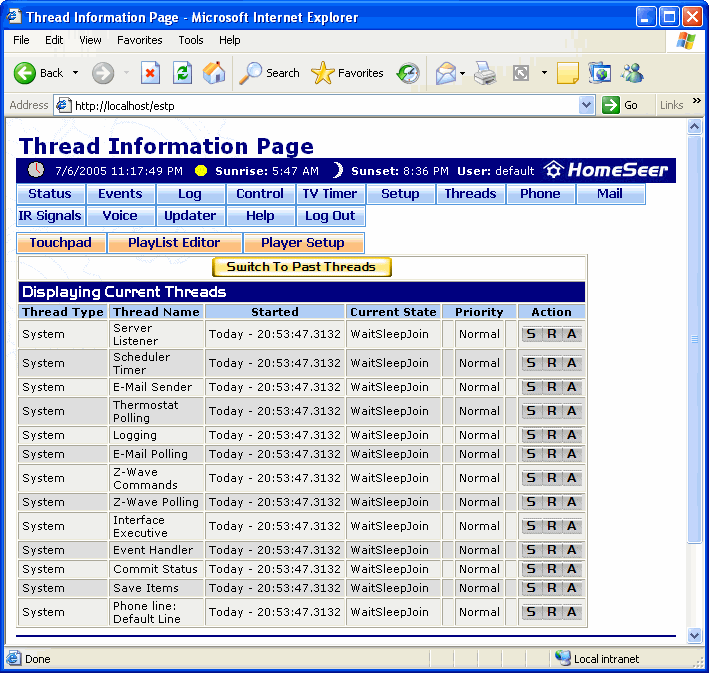

The Threads Page
The Threads screen lists all the threads that are running in the system.  This is useful for discovering problems; if a custom script or event is causing problems, you can stop it or restart it.
To get to this screen, launch the web interface, then click the Threads button beneath the time and date bar (if the option to display it was selected in the Web Site Setup screen).
 VB.NET Scripts remain in the threads view unless they are manually aborted or are replaced with a new version.  The scripts remain in the waiting (WaitSleepJoin) until they are requested to run again.
