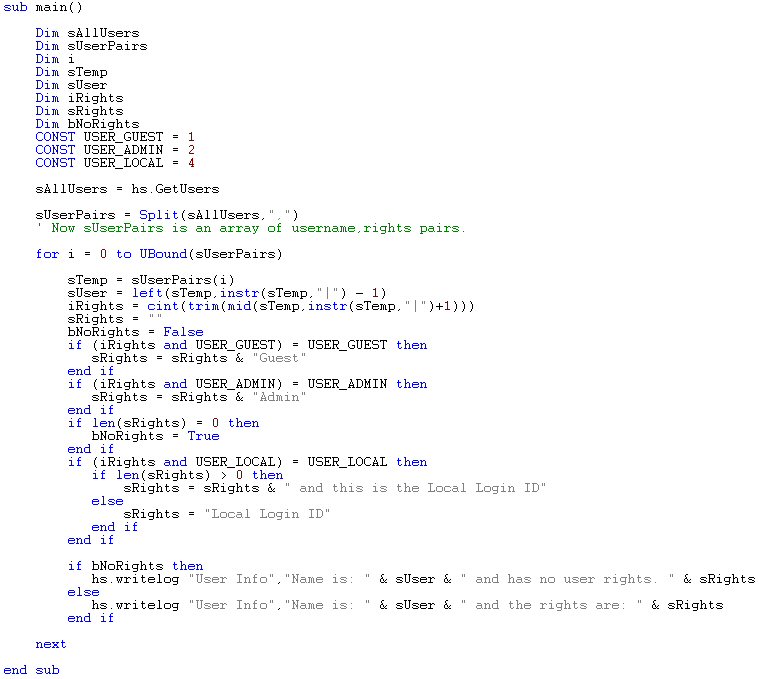

This script will produce a list of the users and their rights to the system log.
Example output from this script:
4/1/2004 12:00:00 AM~!~Event Trigger~!~Trigger
from menu (GetUsers Test)
4/1/2004 12:00:00 AM~!~User Info~!~Name is: guest and has no user rights.
4/1/2004 12:00:00 AM~!~User Info~!~Name is: Mary and has no user rights.
Local Login ID
4/1/2004 12:00:00 AM~!~User Info~!~Name is: Charlie and the rights are:
Admin
