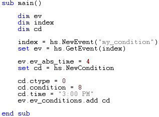

This example creates a new event, sets the event type to Condition, and then adds a condition that triggers at 3:00 PM.
NewCondition Script Example
