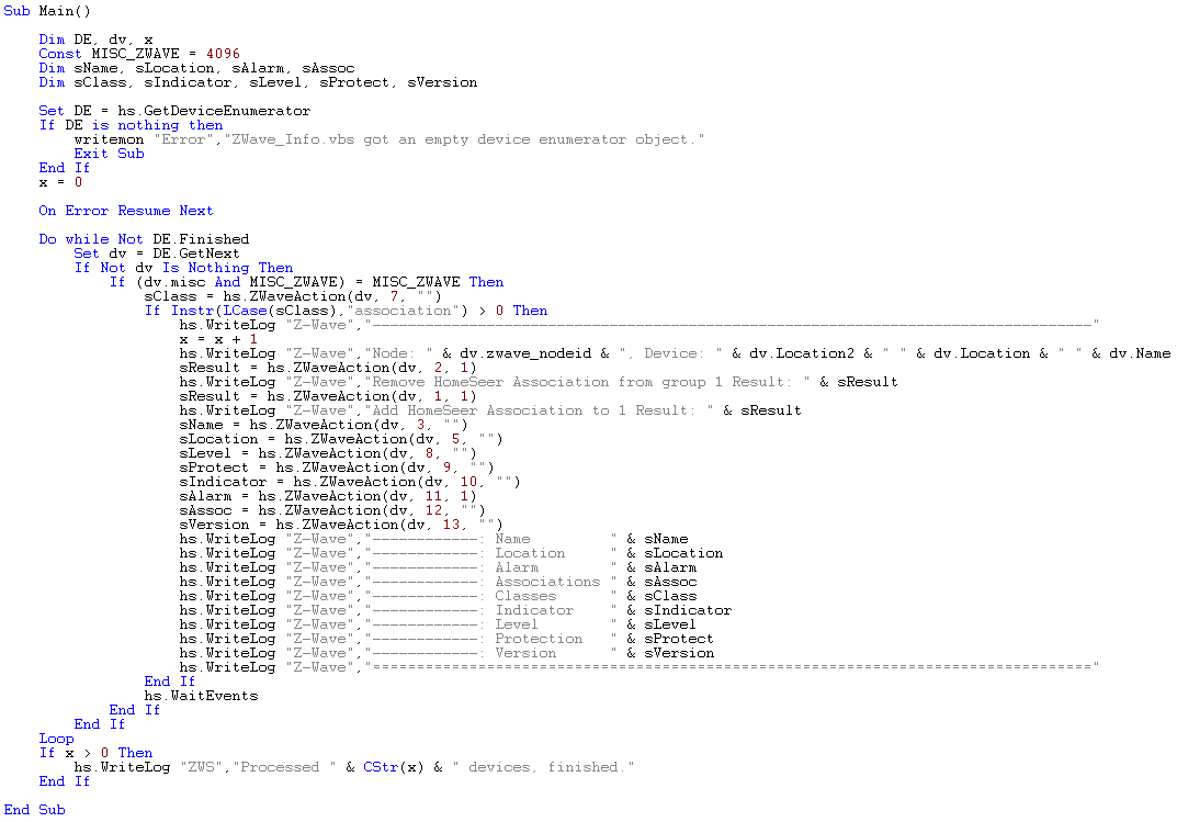

Example
The script sample below is included with this help file - click on the script below for options to open or save a copy of the script.
