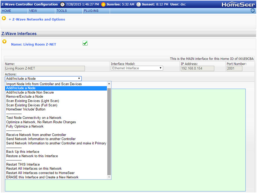

  • An X-10 or Z-Wave Interface for your computer. The CM11A or TI103 connect to your PC’s serial port, the SmartHome PowerLinc connects to a USB port on your computer, and HomeSeer's Z-Wave Interface connects to a USB port. There are many other X-10 interfaces and lighting systems supported by HomeSeer.

[edit] Tell HomeSeer about your hardware

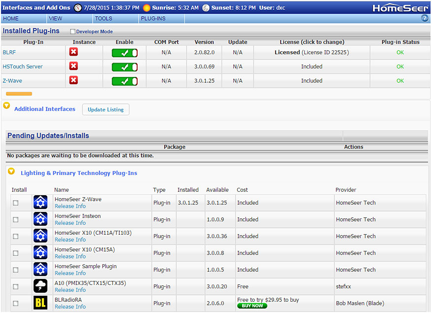

Click the Interfaces tab in the HomeSeer options from the menu Edit  Setup or click on the Setup link on the main screen. Changes to your interfaces take place immediately and a restart of the application is not required.

[edit] Setting up the Insteon Plugin
The Insteon Plugin is a free and optional plugin that will allow HomeSeer to control Powerline devices through the use of an Insteon Powerlinc Interface (required). Using the HomeSeer Web configurator, install the latest Insteon Plugin. After the download is completed, you will be instructed to restart HomeSeer. Exit HomeSeer and plug the interface device to the computer and a proper power outlet if you have not already done so.
After restarting HomeSeer a Schedule dialog may appear to tell you that you are installing "beta" level software. Click "Yes" to continue. A second dialog will inform you that the SmartHome Device Manager (SDM) will be installed. Click "Ok" to continue. A final dialog will give you information as to where release information can be retrieved. The SDM installer will start. After completing the installation the Windows Firewall may prompt you to block or unblock the SmartHome Device Manager. Choose “unblock”.
Note that HomeSeer is moving toward the SmartHome PLM which does not require the SDM manager software and should provide more reliabilty. The PLM version of the plugin is available.
After HomeSeer starts go to the Setup tab in the HomeSeer Web configurator. Under the Interfaces tab, be sure to enable the Insteon plugin for the appropriate devices you will be using ("X10" for x10 devices, "Other" for SmartHome devices or other non-x10 power controlled devices). Click on Insteon Configuration to configure or add devices to HomeSeer.
Note: individual devices that are to be controlled by the Insteon Interface must be added from the Insteon Configuration page and cannot be added from HomeSeer's normal "add device" button.
Device are added by clicking on Manage Devices from the Insteon Configuration page. Devices can be added manually or using the Tap-add capability of the device. When manually adding a device, device ID (located on the device you wish to control) must be supplied. A device name, location, and polling frequency can also be specified if desired. Press Confirm Add Device and follow the onscreen instructions to add the device. When Tap-adding a device, simply follow the instruction on screen which will tell you when to activate the device's tap-link function (see the device's own documentation for details). After you have completed adding the devices, they can be controlled as any other device in HomeSeer.

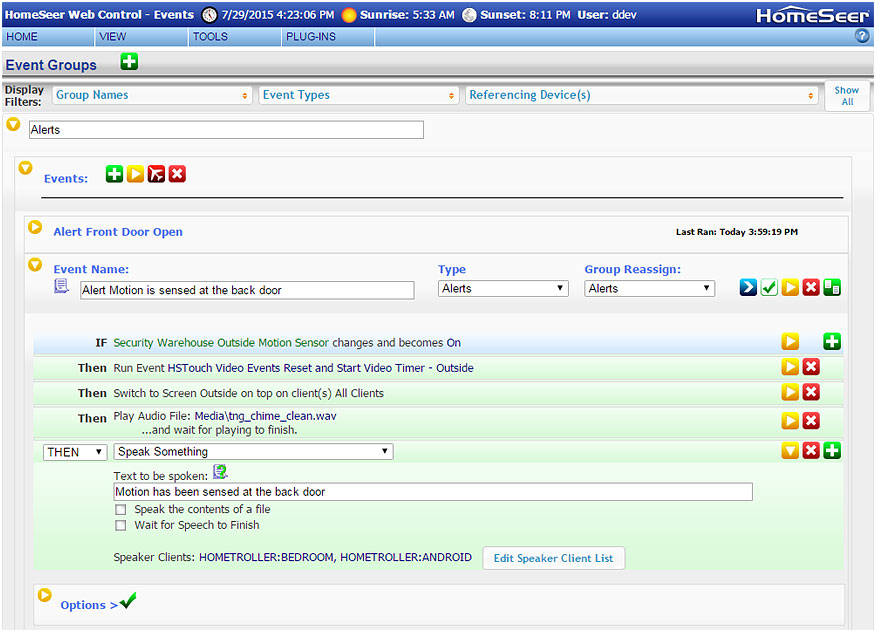

[edit] Events View
This view displays a list of all your configured events. See the Events page for more information on events. The view lists the following information:
  • Name = the name of the event, with any of the following symbols after it:
  • M = the event is a voice command that can be triggered by microphone.
  • P = the event is a voice command that can be triggered by phone.
  • B = The event is a voice command that can be triggered by microphone or phone.
  • Red circle with a slash = the event is disabled and will not be triggered if its trigger conditions are met. These events can still be triggered by voice however.
  • Trigger = the type of trigger for the event which will describe what must happen in order for the event to trigger
  • Actions = Actions that will occur when the event is triggered. An action can be any of the following:
  • Events = other events that will run when this event triggers
  • Scripts = scripts that are executed when the event triggers
  • I/R Command = the infrared commands that are sent when the event triggers
  • Global X10 = housecode wide X10 commands that are executed when the event triggers
  • Application = the application that is launched when the event triggers
  • Sound = the sound that is played when the event triggers
  • Speak = the phrase that is spoken when the event triggers (text to speech must be enabled)
  • Many more actions are available
