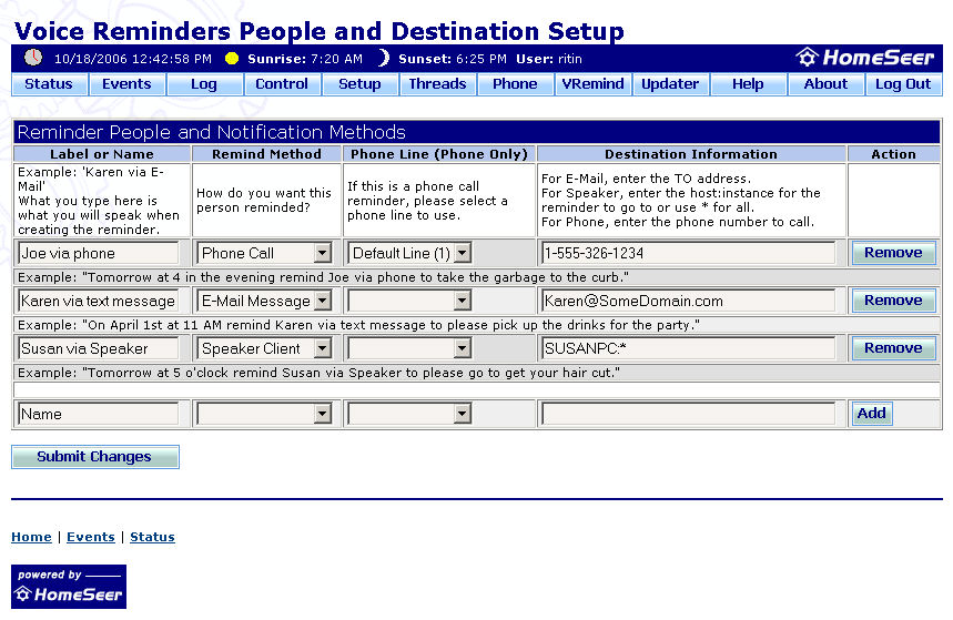

This screen (accessible at the URL  http://homeseersite/vorm) allows you to configure labels/names and destinations for use with HomeSeer's voice recognition based reminders.  (See Voice Commands for more information.)
On this screen you enter the label or name that you wish to speak as part of the reminder, and that label or name contains the rest of the reminder destination information which will be used to deliver the message.
Use the Add/Remove buttons on the end of the rows to add new entries or remove existing entries.  To make a change to an existing entry, change the text or selections and then click the 'Submit Changes' button.
