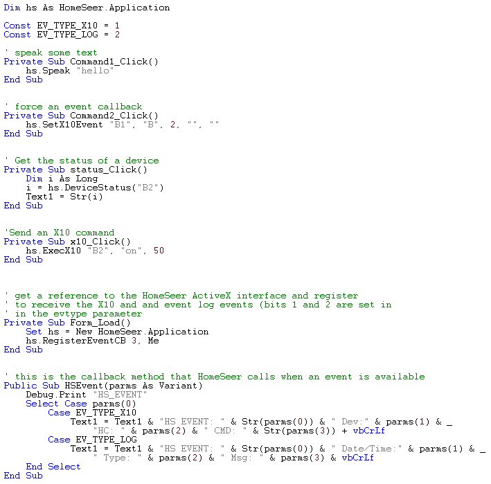

You can control HomeSeer from your own applications. Simply add a reference to it from within your software. You will have access to all of the properties and methods described in the Using Scripts section of this help file.
To use HomeSeer as an ActiveX server, you must first create a reference to HomeSeer within your application. The following two examples show you how to create a link between your Visual Basic 6 or Visual Basic .NET application and HomeSeer.
For instance, you can call into HomeSeer and register a form or class object that will be called when HomeSeer receives an X10 command. Call the following function:
The EVType parameter is a bitmap of event types. The event types are defined as follows:

The obj parameter should be a reference to a form or class object with the following method declared public:
Note: Use Variant instead of Object in non .NET plug-ins.
The parameters are passed in an array of objects. Each entry in the array is a parameter. The number of entries depends on the type of event and are described below. The event type is always present in the first entry or parms(0).

HomeSeer will then call the HSEvent method when the requested event is available. Note that this method should return as quickly as possible as to not interfere with normal HomeSeer event processing. Here is some sample code for a client using the HomeSeer server. Add a reference to the "HomeSeer" object to your project.
